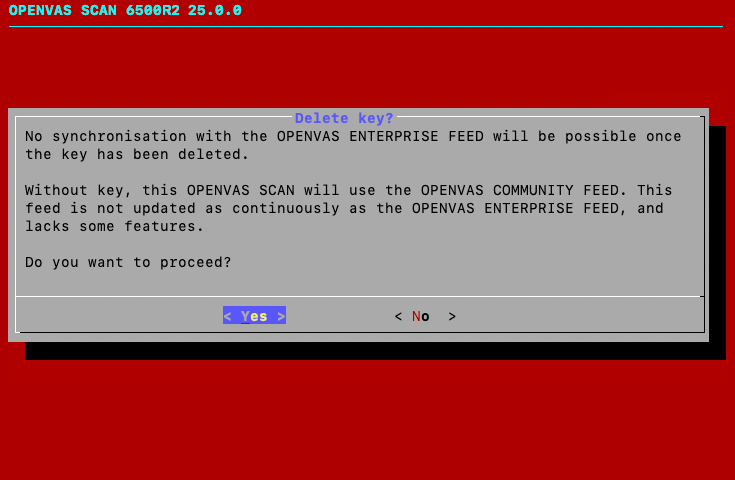

If the subscription key is compromised (for example gets into the hands of third parties), no damage will occur for the rightful owner of the subscription key. Greenbone will deactivate the compromised key, preventing further unauthorized use. A replacement key may be issued at no cost.
A factory reset will delete the subscription key from the appliance and the key has to be re-installed. If a factory reset is planned, contact the Greenbone Support Team to receive a copy of the subscription key.

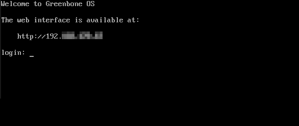

Once turned on, the appliance boots. The boot process can be monitored via the console.
_images/boot_gos.png
Fig. 6.1 Login prompt of the appliance
After the boot process is completed, the login prompt is shown (see Fig. 6.1).

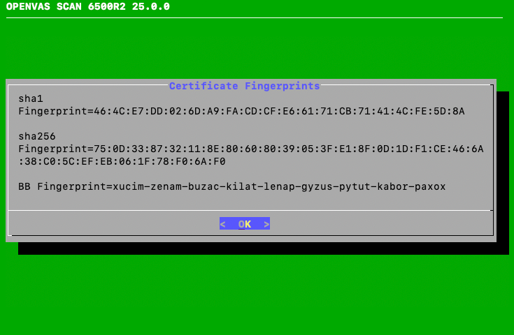

The host key can be verified by displaying its fingerprint as follows:
  1. Log in to the GOS administration menu.
  2. Select Setup and press Enter.
  3. Select Services and press Enter.
  4. Select SSH and press Enter.
  5. Select Fingerprint and press Enter.
    → The fingerprint is displayed.

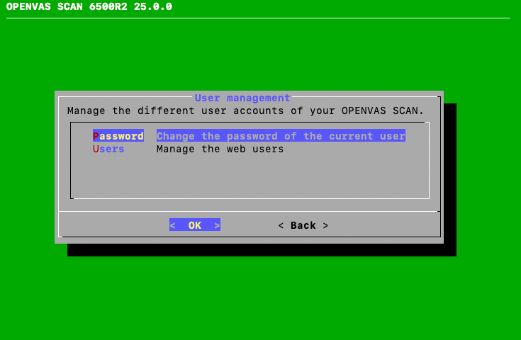

6.2.1 Managing Users

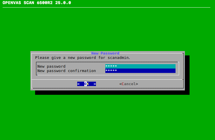

6.2.1.1 Changing the System Administrator Password
The password of the system administrator can be changed. This is especially important during the first basic configuration. The default setting is not suitable for a production environment.
The password can be changed as follows:
  1. Select Setup and press Enter.
  2. Select User and press Enter.
  3. Select Password and press Enter (see Fig. 6.4).
    _images/gos_menu_adminpassword.png
    Fig. 6.4 Accessing the user management
  4. Enter the current password and press Enter (see Fig. 6.5).
    _images/gos_menu_adminpassword2.png
    Fig. 6.5 Changing the system administrator password

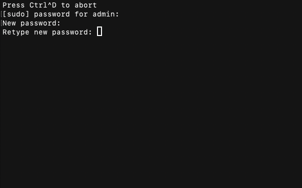

  5. Enter the new password and press Enter.
    Trivial passwords are rejected, including the default password admin.
  6. Repeat the new password and press Enter.
    The change is effective immediately and a commit of the change is not required. A rollback is not possible either.

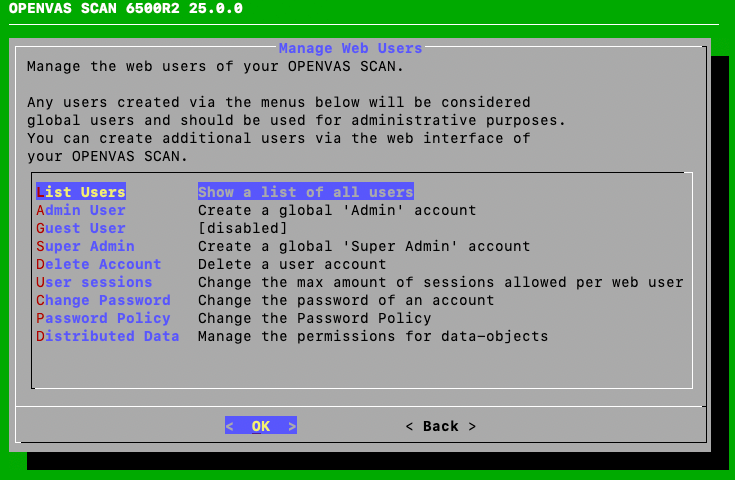

6.2.1.2 Managing Web Users
The GOS administration menu offers the possibility to manage web users (= user accounts for the appliance’s web interface and GMP API).
The appliance models OPENVAS SCAN SENSOR, OPENVAS SCAN 35, and OPENVAS SCAN 25V do not have a web interface.
For these appliance models, this chapter and its subchapters are not relevant.
To use the appliance’s web interface, at least one web administrator (= web user with the role Admin) must be created (see Chapter 6.2.1.3).
Web administrators which were created via the GOS administration menu do not have an owner and are so-called “global objects”. Sometimes they are also referred to as “global web users”. They can only be managed via the GOS administration menu or by a super administrator.
All web users can be displayed as follows:
  3. Select Users and press Enter.
  4. Select List Users and press Enter to display a list of all configured web users (see Fig. 6.6).

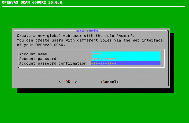

6.2.1.3 Creating a Web Administrator
To use the appliance’s web interface, at least one web administrator (= web user with the role Admin) must be created.
The creation of the first web administrator is only possible using the GOS administration menu.
A web administrator can be created as follows:
  4. Select Admin User and press Enter.
  5. Enter the user name for the web administrator (see Fig. 6.7).
    Only the following characters are allowed for the user name:
    • All alphanumeric characters
    • - (dash)
    • _ (underscore)
    • . (full stop)
    _images/gos_menu_newadmin.png
    Fig. 6.7 Creating a new web administrator
  6. Enter the password for the web administrator twice.
    The password can contain any type of character and can be at most 64 characters long.
    When using special characters, note that these must be available on all used keyboards and correctly supported by all client software and operating systems. Copying and pasting special characters for passwords can lead to invalid passwords depending on these external factors.
  7. Select OK and press Enter.
    → A message informs that the web administrator has been created.
  8. Press Enter to close the message.

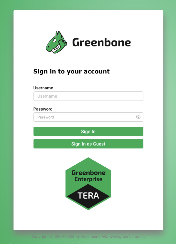

6.2.1.4 Enabling a Guest User
In order for a guest to log in without a password, the guest access must be enabled as follows:
  4. Select Guest User and press Enter.
  5. Enter the user name and the password of an existing web user and press Tab.
  6. Press Enter.
    → The web user is now allowed to log in to the web interface without needing the password (see Fig. 6.8).

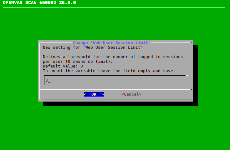

6.2.1.7 Limiting the Number of Concurrent Web Sessions
The same web user may log in to the web interface in multiple web sessions. It is possible to restrict the number of concurrent web sessions.
  4. Select User sessions and press Enter.
  5. Enter the maximum number of concurrent web sessions in the input box (see Fig. 6.10).
    The value can be between 0 and 25. The default value is 0, which means that the number of web sessions is unlimited.
    _images/gos_menu_web_sessions.png
    Fig. 6.10 Limiting the number of web sessions
  6. Press Enter.

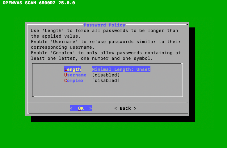

6.2.1.9 Changing the Password Policy
The requirements for passwords can be changed as follows:
  4. Select Password Policy and press Enter.
  5. Select Length and press Enter to set the minimum length of a password.
    The minimum length must be at least 10 characters.
    Select Username and press Enter to determine whether user name and password can be the same.
    Select Complex and press Enter to determine whether a password must contain at least one letter, one number and one symbol.
    _images/gos_menu_passwordpolicy.png
    Fig. 6.12 Changing the password policy
6.2.1.10 Configuring the Settings for Data Objects
Scan configurations, compliance policies, report formats and port lists by Greenbone (hereafter referred to as “objects”) are distributed via the feed. These objects must be owned by a user, the Feed Import Owner.
The objects are downloaded and updated during a feed update if a Feed Import Owner has been set.
Only the Feed Import Owner, a super administrator and users who obtained respective rights are able to delete objects. If objects are deleted, they will be downloaded again during the next feed update.
If the objects remain in the trashcan, they are not yet considered deleted and will not be downloaded again during the next feed update.
If no objects should be downloaded, the Feed Import Owner must be unset.
The Feed Import Owner, a super administrator (default role) and an administrator (default role) who currently has permissions for the objects may also grant additional permissions for the objects to other users (see Chapter 8.4.1.1 or 8.4.1.2). Normally, this only applies to the default roles. Custom roles must be granted permissions manually first.

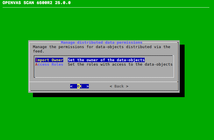

  4. Select Distributed Data and press Enter (see Fig. 6.13).
    _images/gos_menu_distr_objects_1.png
    Fig. 6.13 Configuring the settings for the data objects
  5. Select Import Owner and press Enter.
  6. Select the user that should be Feed Import Owner and press Space.
  7. Press Enter.
The user who is Feed Import Owner cannot be deleted (see Chapter 6.2.1.6). Another Feed Import Owner or (Unset) must be selected.

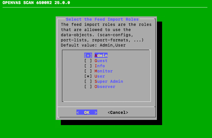

6.2.1.10.2 Setting the Access Roles
By default, the roles User, Admin and Super Admin have read access to the objects, which means they can see and use them on the web interface.
However, the roles that should have read access to the objects can be selected as follows:
  4. Select Distributed Data and press Enter.
  5. Select Access Roles and press Enter.
  6. Select the roles that should be able to see and use the objects and press Space (see Fig. 6.14).
    _images/gos_menu_distr_objects_2.png
    Fig. 6.14 Selecting the roles with read access to the objects
  7. Press Enter.

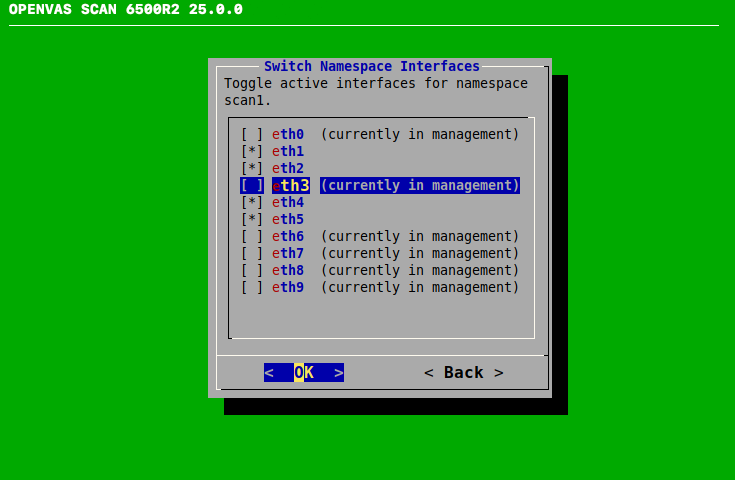

6.2.2.2 Switching an Interface to Another Namespace
Interfaces can be moved to another namespace as follows:
  2. Select Network and press Enter.
  3. Select Configure Namespaces and press Enter.
  4. Press Enter.
    Interfaces that are currently in the scan namespace are marked with * (see Fig. 6.15).
    Interfaces that are currently in the management namespace are labeled accordingly.
    _images/gos_menu_switchingnamespace.png
    Fig. 6.15 Switching interfaces to another namespace
  5. Select the interface that should be moved and and press Space.
    Not all interfaces may be moved to the scan namespace, otherwise the appliance will no longer be accessible.
  6. Press Enter.

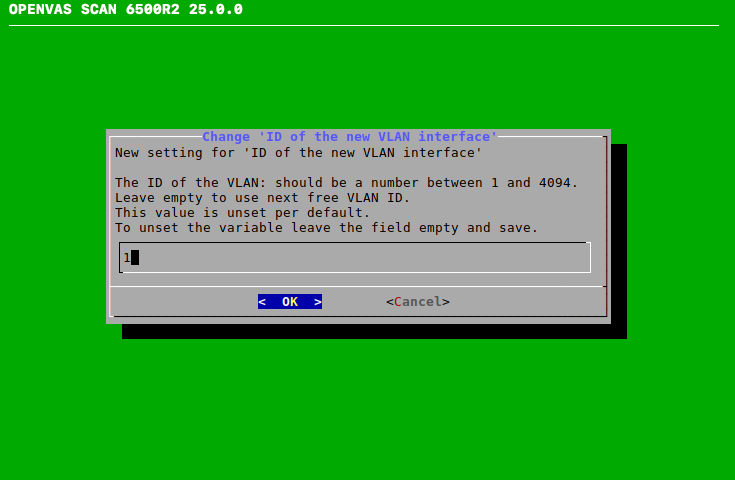

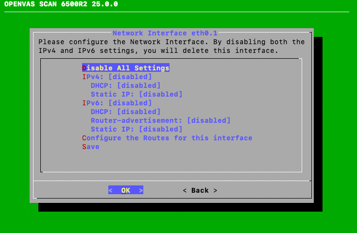

6.2.2.3.5 Configuring VLANs
VLAN interfaces are currently not supported on virtual appliances. If the hypervisor supports virtual switches, those can be used to realize the functionality.
6.2.2.3.5.1 Creating a New VLAN
A new VLAN subinterface can be created as follows:
  1. Select the desired interface (see Chapter 6.2.2.3).
  2. Select Configure the VLAN interfaces on this interface and press Enter.
  3. Select Configure a new VLAN interface and press Enter.
  4. Enter the VLAN ID in the input box and press Enter (see Fig. 6.18).
    _images/gos_menu_vlan_1.png
    Fig. 6.18 Creating a new VLAN subinterface
    → The new interface can be configured using IPv4 and IPv6 (see Fig. 6.19).
    _images/gos_menu_vlan_2.png
    Fig. 6.19 Configuring the VLAN subinterface
6.2.2.3.5.2 Configuring a VLAN
All created subinterfaces can be configured as follows:
  3. Select Configure the VLAN interface … for the desired subinterface.
  4. Configure the subinterface as described in the subchapters of Chapter 6.2.2.3.
    The VLAN can be deleted by selecting Disable All Settings and pressing Enter.

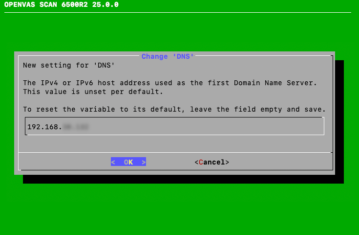

6.2.2.4 Configuring the DNS Server
For receiving the feed and updates, the appliance requires a reachable and functioning DNS (Domain Name System) server for name resolution. This setting is not required if the appliance uses a proxy for downloading the feed and updates.
If DHCP is used for the configuration of the network interfaces, the DNS servers provided by the DHCP protocol are used.
The appliance supports up to three DNS servers. At least one DNS server is required. Additional servers will only be used if an outage of the first server occurs.
The DNS server can be configured as follows:
  3. Select Namespace: Management and press Enter.
  4. Select DNS and press Enter.
  5. Select the desired DNS server and press Enter.
  6. Enter the IP address used as the DNS server in the input box and press Enter (see Fig. 6.21).
    _images/gos_menu_dns.png
    Fig. 6.21 Configuring the DNS server
Whether the DNS server can be reached and is functional can be determined by performing a self-check (see Chapter 6.3.1).

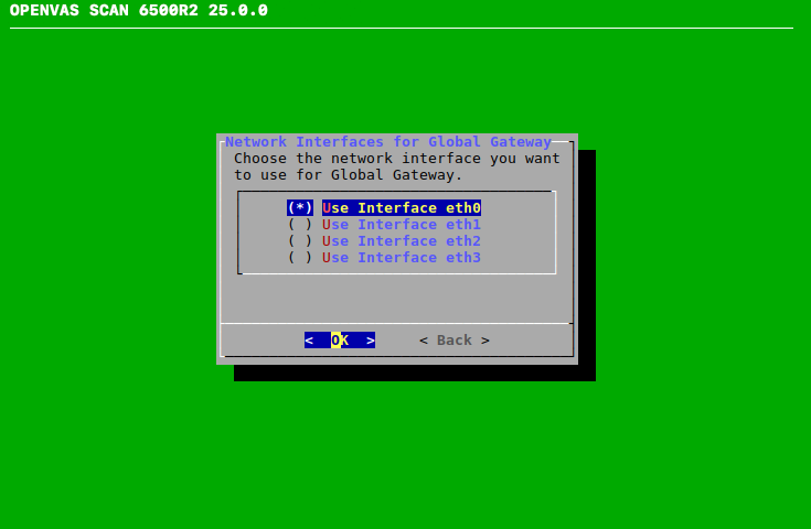

  4. Select Global Gateway for IPv4 or Global Gateway (IPv6) for IPv6 and press Enter.
  5. Select the desired interface and press Enter (see Fig. 6.22).
    _images/gos_menu_globalgateway.png
    Fig. 6.22 Configuring the global gateway
  6. Enter the IP address used as the global gateway in the input box and press Enter.

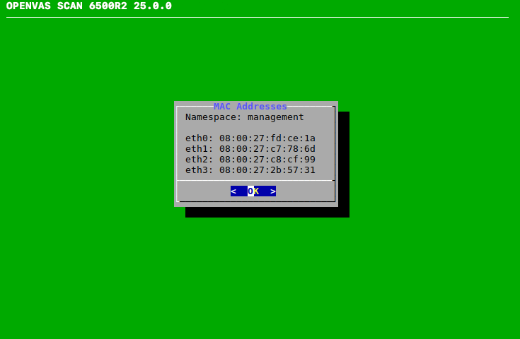

6.2.2.8 Displaying the MAC and IP Addresses and the Network Routes
The used MAC addresses, the currently configured IP addresses and the appliance’s network routes can be displayed in a simple overview.
This does not support the configuration of the MAC addresses.
The MAC addresses, IP addresses or network routes can be displayed as follows:
  3. Select the namespace for which the IP addresses, MAC addresses or network routes should be displayed and press Enter.
  4. Select MAC, IP, or Routes and press Enter.
    → The MAC/IP addresses or the network routes of the selected namespace are displayed (see Fig. 6.25).
    _images/gos_menu_mac.png
    Fig. 6.25 Displaying the MAC/IP addresses or network routes

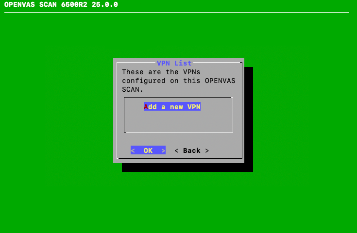

  3. Select Add a new VPN and press Enter (see Fig. 6.26).
    _images/gos_menu_vpn.png
    Fig. 6.26 Adding a VPN connection

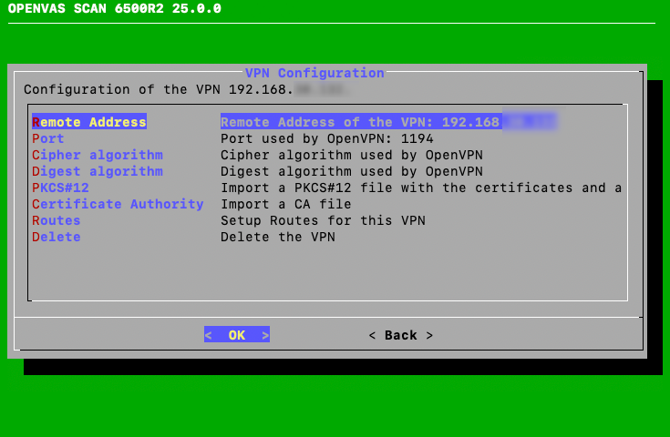

6.2.3.2 Editing or Deleting a VPN Connection
The VPN connection can be edited as follows:
  2. Select VPN and press Enter.
    _images/gos_menu_vpn_2.png
    Fig. 6.27 Editing or deleting a VPN connection
The following actions are available:
Remote Address
Define the VPN’s IP address.
Port
Define the port used by OpenVPN. By default, the port is 1194.
Cipher algorithm
Select the cipher algorithm. By default, the default setting of OpenVPN is used.
Digest algorithm
Select the digest algorithm. By default, the default setting of OpenVPN is used.
PKCS#12
Replace the PKCS#12 file.
Routes
Add a route for the VPN connection. Target IP address, net mask and target gateway must be defined.
Only one route can be set up for the VPN connection.
Delete
Delete the VPN connection.

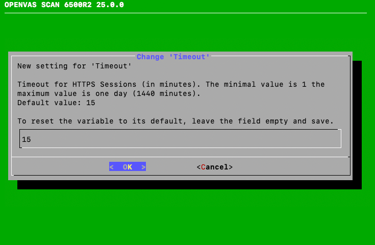

6.2.4.1 Configuring the Timeout of the Web Interface
If no action is performed on the web interface for a defined period of time, the user is logged out automatically. The timeout value can be set as follows:
  2. Select Services and press Enter.
  3. Select HTTPS and press Enter.
  4. Select Timeout and press Enter.
  5. Enter the desired timeout value in the input box and press Enter (see Fig. 6.28).
    The value can be between 1 and 1440 minutes (1 day). The default value is 15 minutes.
    The value must be higher than that for the timeout of running HTTPS requests (see Chapter 6.2.4.2).
    _images/gos_menu_httpstimeout.png
    Fig. 6.28 Setting the web interface timeout value

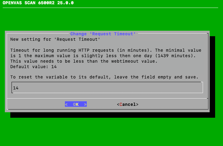

6.2.4.2 Configuring the Timeout for Running HTTPS Requests
If HTTPS requests, such as report generation, take longer than a specified time limit, they will be aborted. The timeout value can be set as follows:
  4. Select Request Timeout and press Enter.
  5. Enter the desired timeout value in the input box and press Enter (see Fig. 6.29).
    The value can be between 1 and 1439 minutes (23 h and 59 min). The default value is 14 minutes.
    The value must be lower than that of the web interface timeout (see Chapter 6.2.4.1).
    _images/gos_menu_httpsrequesttimeout.png
    Fig. 6.29 Setting the HTTPS request timeout value

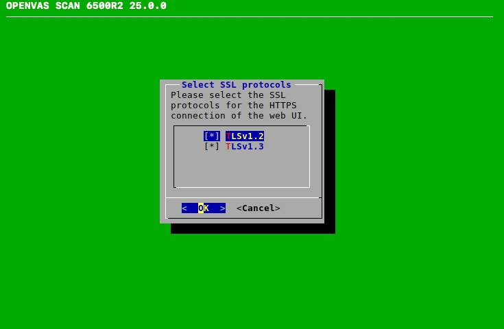

6.2.4.3 Configuring the TLS Protocols
The TLS protocols for the HTTPS connection of the web interface can be configured as follows:
  4. Select Protocols and press Enter.
  5. Select the desired protocol version and press Space (see Fig. 6.30).
    By default, both versions are selected.
    If TLSv1.2 is selected (either alone or in combination with version 1.3), the ciphers for the HTTPS connection can be configured (see Chapter 6.2.4.4).
    If only TLSv1.3 is selected, the default value for -ciphersuites val of OpenSSL for the cipher suites is used. In this case, the menu option for configuring the ciphers is not available.
    _images/gos_menu_httpsprotocols.png
    Fig. 6.30 Configuring the TLS protocols for the HTTPS connection
  6. Select OK and press Enter.

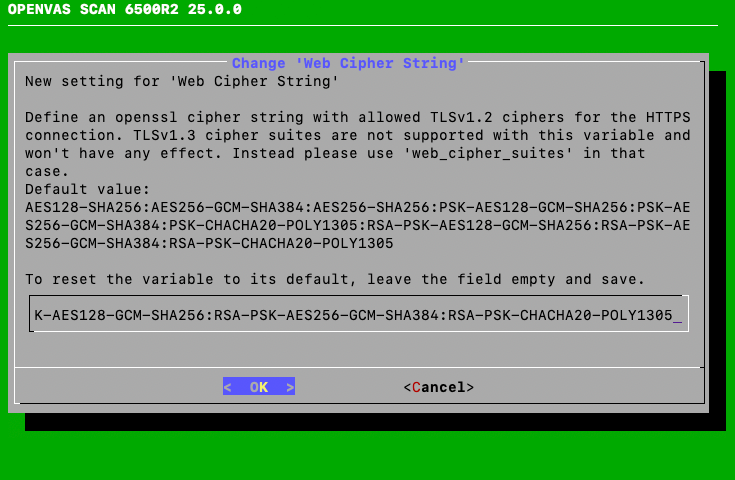

6.2.4.4 Configuring the Ciphers
If TLS version 1.2 is used for the HTTPS connection of the web interface (either alone or in combination with version 1.3, see Chapter 6.2.4.3), the HTTPS ciphers can be configured to further enhance the security of the web interface.
The current setting only allows secure ciphers using at least 128 bit key length, explicitly disallowing the cipher suites used by SSLv3 and TLSv1.0.
No ciphers exist for TLSv1.1.
The HTTPS ciphers can be configured as follows:
  4. Select Ciphers and press Enter.
  5. Enter the desired value in the input box and press Enter (see Fig. 6.31).
    The string used to define the ciphers is validated by OpenSSL and must comply with the syntax of an OpenSSL cipher list.
    More information about the syntax can be found here.
    _images/gos_menu_httpsciphers.png
    Fig. 6.31 Configuring the ciphers

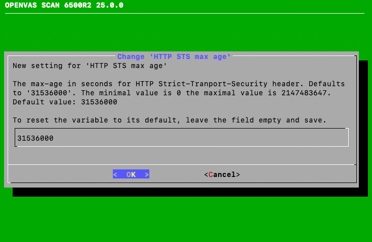

Setting the Maximum Allowed Age of the HSTS Header
When HTTP STS is enabled, the maximum allowed age for the HSTS header can be set as follows:
  4. Select HTTP STS max age and press Enter.
  5. Enter the maximum age in seconds in the input box and press Enter (see Fig. 6.32).
    _images/gos_menu_hsts_max_age.png
    Fig. 6.32 Setting the maximum allowed age for the HTTP STS header

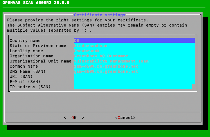

  7. Provide the settings for the certificate (see Fig. 6.33), select OK and press Enter.
    It is valid to generate a certificate without a common name. However, a certificate should not be created without (a) Subject Alternative Name(s) (SAN).
    If a common name is used, it should be the same as one of the SANs.
    _images/gos_menu_httpscertificate.png
    Fig. 6.33 Providing settings for the certificate
    → When the process is finished, a message informs that the certificate can be downloaded.
  9. Select Download and press Enter.
  10. Open the web browser and enter the displayed URL.
  11. Download the PEM file.
  12. In the GOS administration menu, press Enter.
    → When the certificate is retrieved by the appliance, the GOS administration menu displays the fingerprint of the certificate for verification.
  13. Check the fingerprint and confirm the certificate by pressing Enter.

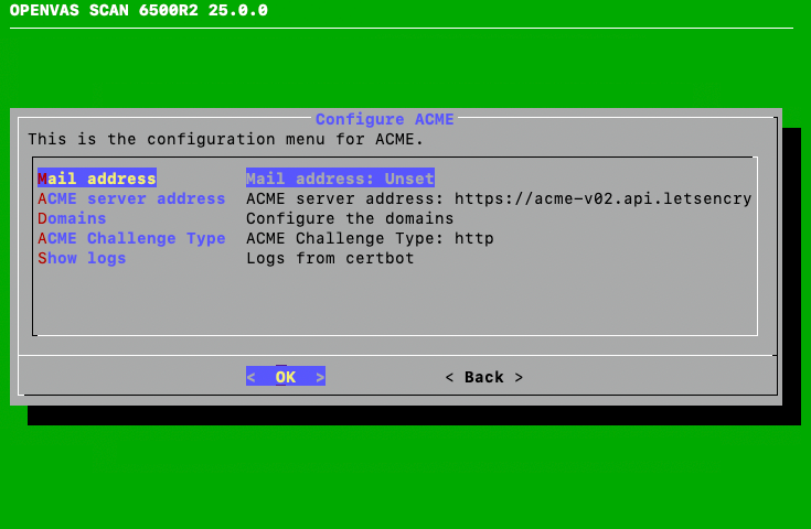

6.2.4.8.4 Configuring the Automatic Certificate Management Environment
GOS supports the use of an ACME (Automatic Certificate Management Environment) provider. This allows to automatically renew certificates for the configured domains, which in turn allows much smaller lifetimes for certificates and thus, increases security.

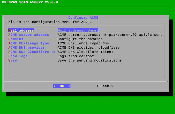

The ACME can be configured as follows:
  4. Select Certificate and press Enter.
  5. Select ACME and press Enter.
    _images/gos_menu_acme-1.png
    Fig. 6.35 Providing settings for the ACME
  6. Select Mail address and press Enter.
  7. Enter the e-mail address that is registered with the ACME provider in the input box and press Enter.
  8. Select ACME server address and press Enter.
  9. Enter the ACME server address in the input box and press Enter.
  10. Select Domains and press Enter.
  11. Select a domain and press Enter.
  12. Enter the domain name for which certificates should be issued in the input box and press Enter.
  13. Select Back and press Enter.
  14. Select ACME Challenge Type and press Enter.
  15. Select how the domain ownership should be verified and press Space.
    • http: the ACME server accesses a temporary validation file over HTTP (port 80). This method is suitable for publicly accessible web services.
    • dns: a temporary DNS TXT record is created. This method is required for wildcard certificates (for example, *.example.com).
  16. Press Enter.

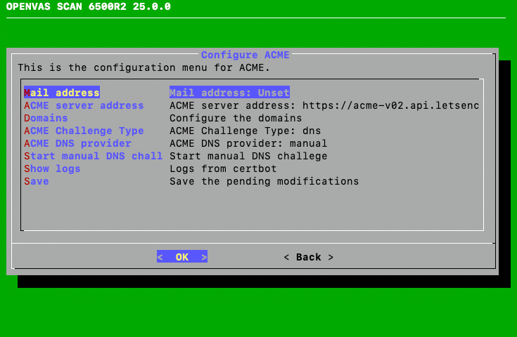

    If the challenge type dns has been selected, additional menu items are displayed.
  17. Select ACME DNS provider and press Enter.
  18. Select the DNS provider which determines how the required TXT records are created and press Space.
    • manual: the system administrator creates and removes the required DNS TXT records manually. This option works with any DNS provider but requires user interaction whenever a certificate is requested or renewed.
    • cloudflare: the ACME client uses the Cloudflare DNS API to automatically create and remove the required DNS TXT records.
    • rfc2136: the ACME client updates DNS records dynamically using the RFC 2136 Dynamic DNS Update protocol.
  19. Press Enter.
    When manual has been selected, the DNS validation process must be done manually.
    _images/gos_menu_acme-2.png
    Fig. 6.36 Configuring the ACME DNS mode manual
  20. Select Start manual DNS challenge and press Enter.
    → The ACME client generates a challenge token.
    The DNS TXT record that must be created is displayed.
  21. Create the TXT record in the authoritative DNS zone.
    → After the DNS change has propagated, the ACME client verifies the record with the ACME server.
    If validation succeeds, the certificate is issued.
    This process must be repeated each time a new certificate is requested.
    When the ACME DNS provider cloudflare has been selected, a Cloudflare API token with appropriate permissions for the managed DNS zone must be provided.
    _images/gos_menu_acme-3.png
    Fig. 6.37 Configuring the ACME DNS provider cloudflare
  22. Select ACME DNS Cloudflare Token and press Enter.
  23. Enter the API token used for authentication with Cloudflare in the input box and press Enter.

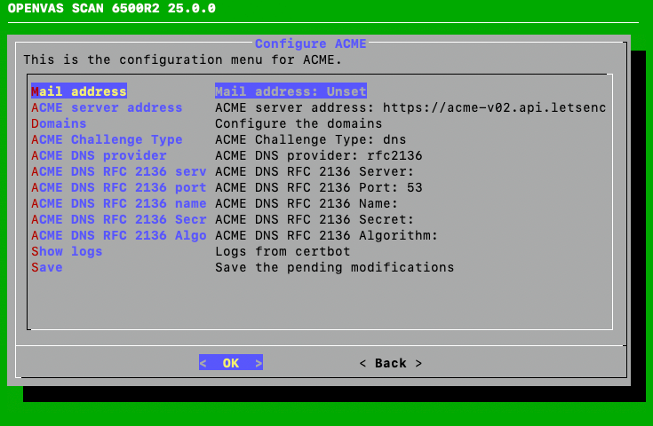

    When the ACME DNS provider rfc2136 has been selected, access to the DNS server and appropriate authentication must be provided.
    The ACME client connects to this server to create and remove the required DNS TXT records.
    _images/gos_menu_acme-4.png
    Fig. 6.38 Configuring the ACME DNS provider rfc2136
  24. Select ACME DNS RFC 2136 server and press Enter.
  25. Enter the IP address of the authoritative DNS server that accepts RFC 2136 Dynamic DNS Update requests in the input box and press Enter.
  26. Select ACME DNS RFC 2136 port and press Enter.
  27. Enter the port used to connect to the DNS server in the input box and press Enter.
    The default port is 53, which is the standard port for DNS services.
  28. Select ACME DNS RFC 2136 name and press Enter.
  29. Enter the name (key identifier) of the TSIG key used to authenticate Dynamic DNS Update requests in the input box and press Enter.
    This must match the key name configured on the DNS server.
  30. Select ACME DNS RFC 2136 Secret and press Enter.
  31. Enter the shared secret associated with the TSIG key in the input box and press Enter.
    It is used together with the key name to authenticate update requests.
  32. Select ACME DNS RFC 2136 Algorithm and press Enter.
  33. Enter the TSIG algorithm used to sign and verify Dynamic DNS Update requests, for example HMAC-SHA256, HMAC-SHA512, or HMAC-MD5, in the input box and press Enter.
    The selected algorithm must match the configuration on the DNS server.
  34. Select Show logs and press Enter.
    → The log view provides detailed information about certificate issuance and renewal processes.
6.2.4.9 Displaying Fingerprints
The fingerprints of the used certificate can be displayed and checked as follows:
  4. Select Fingerprints and press Enter.
    → The following fingerprints of the currently active certificate are displayed:
    • SHA1
    • SHA256
    • BB
    _images/gos_menu_httpsfingerprints.png
    Fig. 6.39 Displaying the fingerprints

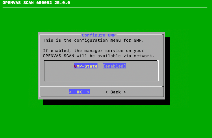

6.2.5 Configuring the Greenbone Management Protocol (GMP)
The Greenbone Management Protocol (GMP) can be used for the communication of in-house software with the appliance.
GMP can be activated using the GOS administration menu as follows:
The SSH service must be enabled before GMP can be enabled (see Chapter 6.2.7).
  3. Select GMP and press Enter.
  4. Press Enter to enable or disable GMP (see Fig. 6.40).
_images/gos_menu_gmp.png
Fig. 6.40 Enabling GMP

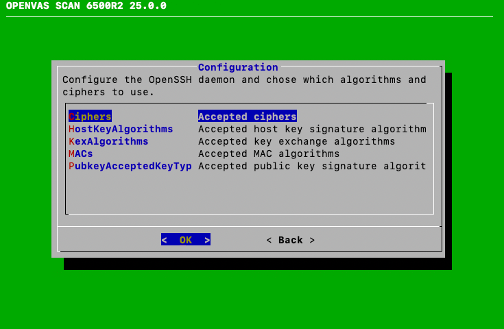

6.2.7.2 Configuring the Used Algorithms and Ciphers
The algorithms and ciphers used by the SSH daemon can be configured as follows:
  3. Select SSH and press Enter.
  4. Select Configuration and press Enter.
  5. Select the desired setting and press Enter (see Fig. 6.41).
    _images/gos_menu_ssh_algo.png
    Fig. 6.41 Configuring the used algorithms and ciphers
  6. Select the desired value(s) and press Space.
    → Enabled values are marked with *.
    By default, all values are enabled for all settings.
    The settings can also be reset to the default by deselecting all values and saving the changes.
  7. Press Enter.

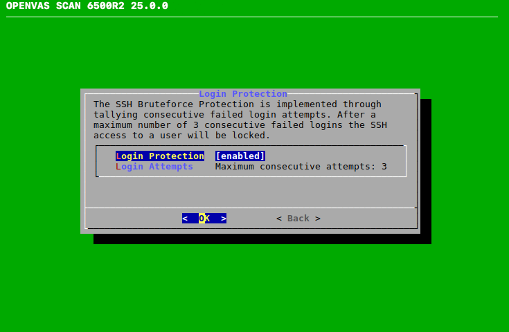

6.2.7.3 Enabling and Managing a Login Protection
A login protection can be enabled, which means that if a number of consecutive login attempts fail, the user will be locked.
A self-scan, which means that a scan where the appliance is part of the scan target, may trigger the login protection.
The login protection does not block logging in via SSH admin key if such a key is set up (see Chapter 6.2.7.4).
6.2.7.3.1 Setting Up the Login Protection
The login protection can be enabled and managed as follows:
  4. Select Login Protection and press Enter.
  5. Select Login Protection and press Enter (see Fig. 6.42).
    _images/gos_menu_sshprotect.png
    Fig. 6.42 Setting a login protection
    → A message informs that the login protection can lead to a locked SSH access.
  6. Select Continue and press Enter to enable the login protection.
  7. Select Login Attempts and press Enter.
  8. Enter the desired value and press Enter.
6.2.7.3.2 Unlocking a Locked System
In case the system is locked after too many failed login attempts, it must be unlocked using console access (serial, hypervisor or monitor/keyboard) as follows:
  3. Select Unlock SSH and press Enter.
    → The login attempt counter is reset.
  4. Press Enter to close the message.

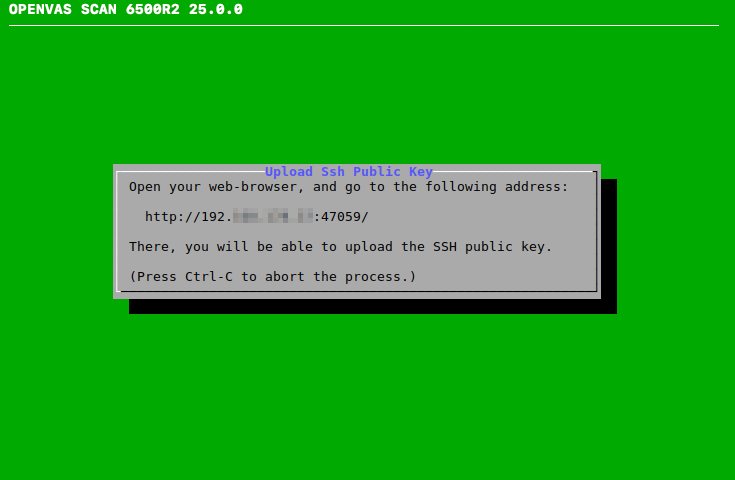

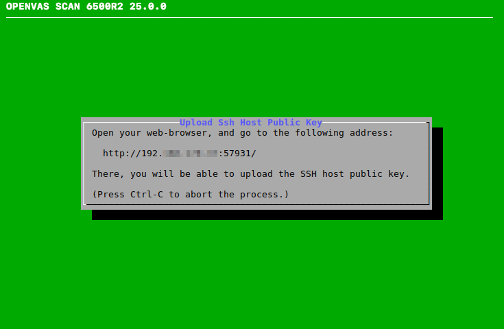

An SSH admin key can be uploaded as follows:
  4. Select Admin Key and press Enter.
  5. Open the web browser and enter the displayed URL (see Fig. 6.43).
    _images/gos_menu_sshadminkey.png
    Fig. 6.43 Uploading an SSH public key
  6. Click Browse…, select the SSH public key and click Upload.
    → When the upload is completed, a message informs that the login via SSH is possible.

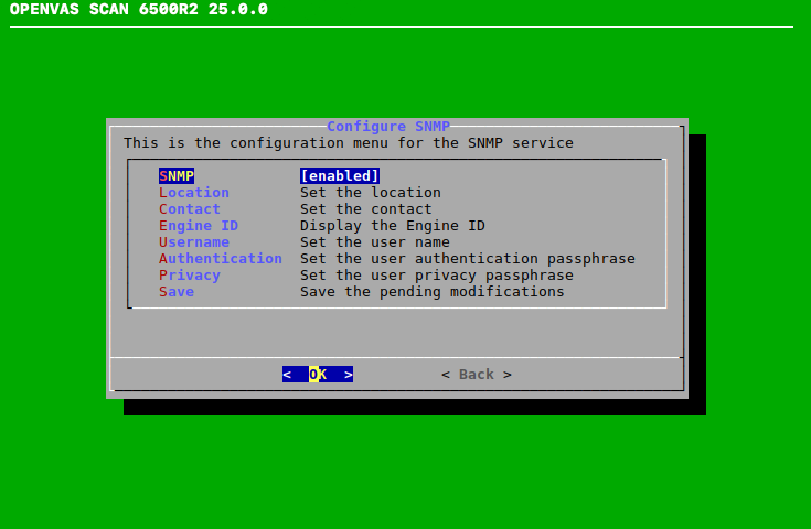

6.2.8 Configuring SNMP
The appliance supports SNMPv3 for read access, and SNMPv1 for sending traps through alerts and monitoring vital parameters of the appliance.
The supported parameters are specified in a Management Information Base (MIB) file. The current MIB is available in the Greenbone TechDoc Portal.
SNMPv3 can be configured as follows:
  3. Select SNMP and press Enter.
  4. Select SNMP and press Enter to enable SNMP.
    → Several new options are displayed (see Fig. 6.44).
    _images/gos_menu_snmp.png
    Fig. 6.44 Configuring SNMPv3
  5. Select Location and press Enter.
  6. Enter the location of the SNMP service in the input box and press Enter.
  7. Select Contact and press Enter.
  8. Enter the contact of the SNMP service in the input box and press Enter.
  9. Select Username and press Enter.
  10. Enter the SNMP user name in the input box and press Enter.
    When configuring the authentication and privacy passphrase, note that the appliance uses SHA-1 and AES128 respectively.
  11. Select Authentication and press Enter.
  12. Enter the SNMP user authentication passphrase in the input box and press Enter.
  13. Select Privacy and press Enter.
  14. Enter the SNMP user privacy passphrase in the input box and press Enter.
    After a user has been configured, the appliance’s engine ID can be displayed by selecting Engine ID and pressing Enter.
  15. Afterwards, test the read access of the SNMP service under Linux/Unix using snmpwalk:
$ snmpwalk -v 3 -l authPriv -u user -a sha -A password -x aes -X key 192.168.222.115
iso.3.6.1.2.1.1.1.0 = STRING: "OPENVAS SCAN"
iso.3.6.1.2.1.1.3.0 = Timeticks: (347275248) 40 days, 4:39:12.48
iso.3.6.1.2.1.1.4.0 = STRING: "Greenbone AG <info@greenbone.net>"

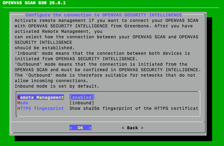

6.2.9 Configuring the Connection to OPENVAS SECURITY INTELLIGENCE
Remote management via OPENVAS SECURITY INTELLIGENCE is currently only available for the appliance models OPENVAS SCAN G10, OPENVAS SCAN G30, OPENVAS SCAN G90, and OPENVAS SCAN VIRTUAL.
OPENVAS SECURITY INTELLIGENCE is a central platform for managing multiple appliances.
It provides an overview of all connected systems and their status in real time. Furthermore, all operating system settings and configurations of the appliances can be viewed.
The connected appliances can be controlled via OPENVAS SECURITY INTELLIGENCE. Among other things, appliances can be rebooted and shut down, and feed updates and GOS upgrades can be performed. Some actions can also be performed for multiple appliances at once.

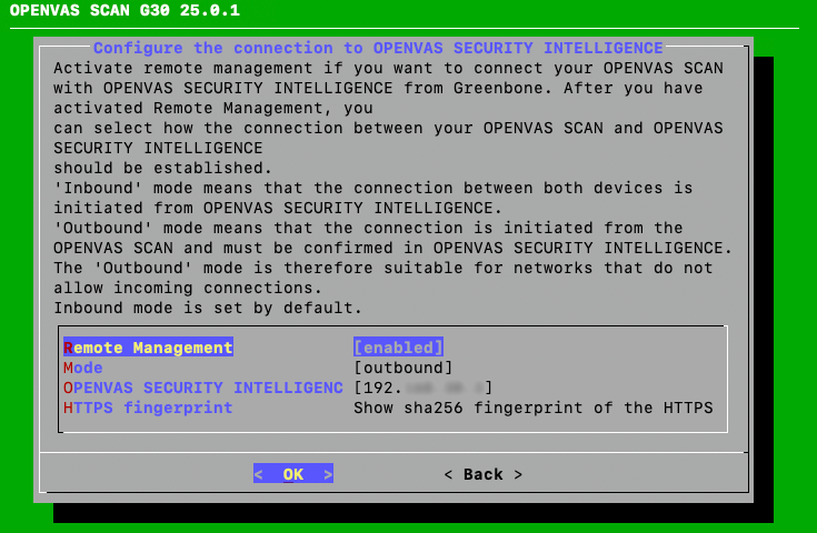

There are two ways to connect an appliance to OPENVAS SECURITY INTELLIGENCE:
  • Inbound mode: the connection is initiated by OPENVAS SECURITY INTELLIGENCE. This method is used for appliances that are located in networks that allow inbound communication.
  • Outbound mode: the connection is initiated by the appliance. This method is used for appliances that are located in networks that only allow outbound communication.
6.2.9.1 Preparing the Appliance for Inbound Mode
An appliance can be prepared for connecting via inbound mode as follows:
  3. Select Remote Management and press Enter.
  4. To enable remote management, select Remote Management and press Enter.
    Depending on the currently set mode, the mode may need to be changed first.
    • If the mode is set to inbound, continue with step 7.
    • If the mode is set to outbound, continue with step 5.
  5. If the mode is outbound, select Mode and press Enter.
    → A warning informs that changing the connection mode will terminate any existing pairing with OPENVAS SECURITY INTELLIGENCE.
  6. Select Continue and press Enter.
    → The mode is set to inbound.
  7. Select Save and press Enter.
    → The appliance can now be connected to OPENVAS SECURITY INTELLIGENCE via inbound mode.
    _images/gos_menu_rm_inbound.png
    Fig. 6.45 Preparing the appliance for inbound mode
6.2.9.2 Preparing the Appliance for Outbound Mode
An appliance can be prepared for connecting via outbound mode as follows:
    • If the mode is set to inbound, continue with step 5.
    • If the mode is set to outbound, continue with step 7.
  5. If the mode is inbound, select Mode and press Enter.
    → The mode is set to outbound.
  7. Select OPENVAS SECURITY INTELLIGENCE Address and press Enter.
  8. Enter the domain name or IP address of the OPENVAS SECURITY INTELLIGENCE instance, followed by :443 for the port, in the input box and press Enter.
  9. Select Save and press Enter.
    If the appliance was already connected to an OPENVAS SECURITY INTELLIGENCE instance, a warning asks whether the current pairing should be released first.
    → The appliance will try to connect to the instance of OPENVAS SECURITY INTELLIGENCE that the domain name/IP address was provided for. The appliance can now be connected to OPENVAS SECURITY INTELLIGENCE via outbound mode.
    _images/gos_menu_rm_outbound.png
    Fig. 6.46 Preparing the appliance for outbound mode
Appliances connected via the outbound mode can send scan data to OPENVAS SECURITY INTELLIGENCE. This settings must be enabled in the user settings (see Chapter 7.7).

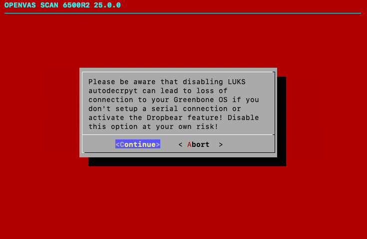

    → A warning informs that when auto-decrypt is disabled, a serial connection, or a Dropbear SSH server is required when starting the appliance (see Fig. 6.47).
    _images/gos_menu_luks_1.png
    Fig. 6.47 Disabling auto-decrypt
  4. Select Continue and press Enter.
    → A message informs that auto-decrypt was disabled successfully.

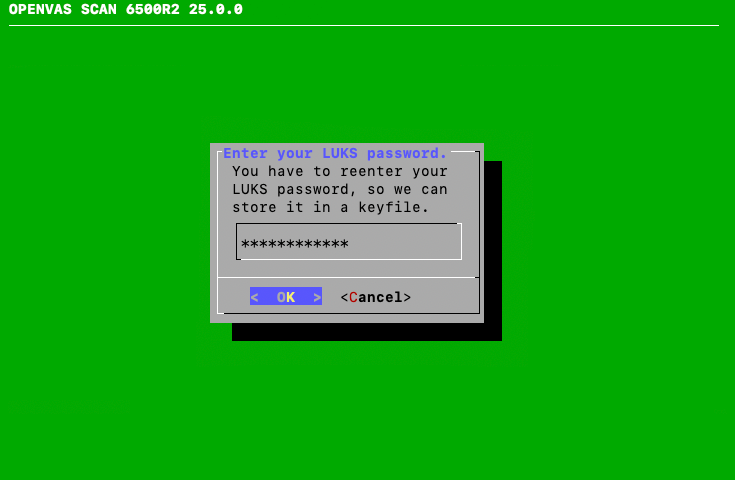

  4. Enter the encryption password (see Chapter 6.2.11.1) in the input box and press Enter (see Fig. 6.48).
    _images/gos_menu_luks_3.png
    Fig. 6.48 Enabling auto-decrypt
    → A message informs that auto-decrypt was enabled successfully.

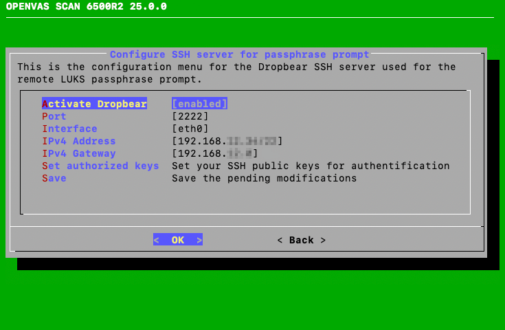

6.2.11.4 Using Dropbear SSH for the Disk Decryption
6.2.11.4.1 Configuring the Dropbear SSH Server
If auto-decrypt is disabled, Dropbear can be used in order to connect via SSH and entering the password remotely.
When enabled, the Dropbear SSH server is only set up during boot time, accepts authentication via SSH key and provides a prompt for the encryption password.
An SSH key pair is required on the system from which the connection to the Dropbear SSH server should be established. It is recommended to use a dedicated key.
The interface used for the Dropbear SSH server must be one that is configured in the appliance’s network settings (see Chapter 6.2.2). Its interface ID, IP address, and gateway are required for the Dropbear SSH server.
  2. Select Disk Encryption and press Enter.
  3. Select Dropbear and press Enter.
  4. Select Activate Dropbear and press Enter.
    → Dropbear is activated and the menu options for configuring the Dropbear SSH server are displayed (see Fig. 6.49).
    _images/gos_menu_luks_2.png
    Fig. 6.49 Setting up the Dropbear SSH server
    The default port for the Dropbear SSH server is 2222. If a port other than 2222 should be used, it must be configured explicitly. If no port is configured, the default port is used.
  5. Select Port and press Enter.
  6. Enter the port for the Dropbear SSH server in the input box and press Enter.
  7. Select Interface and press Enter.
  8. Enter the interface used for the Dropbear SSH server in the input box and press Enter.
  9. Select IPv4 Address and press Enter.
  10. Enter the IPv4 address of the previously set interface including its prefix length in the input box and press Enter.
  11. Select IPv4 Gateway and press Enter.
  12. Enter the IPv4 address of the global gateway of the previously set interface in the input box and press Enter.
  13. Select Set authorized keys and press Enter.
    Up to two SSH keys can be added.
  14. Select Key 1/Key 2 and press Enter.
  15. Enter the SSH public key in the input box and press Enter.
  16. Select Back and press Enter.
  17. Select Save and press Enter.

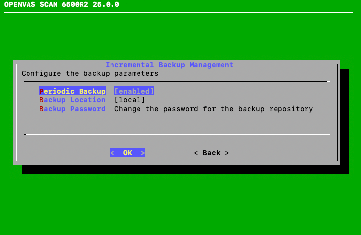

6.2.12.1 Enabling Periodic Backups
Periodic backups can be enabled as follows:
  2. Select Backup and press Enter.
  3. Select Periodic Backup and press Enter (see Fig. 6.50).
    → Periodic backups are enabled.

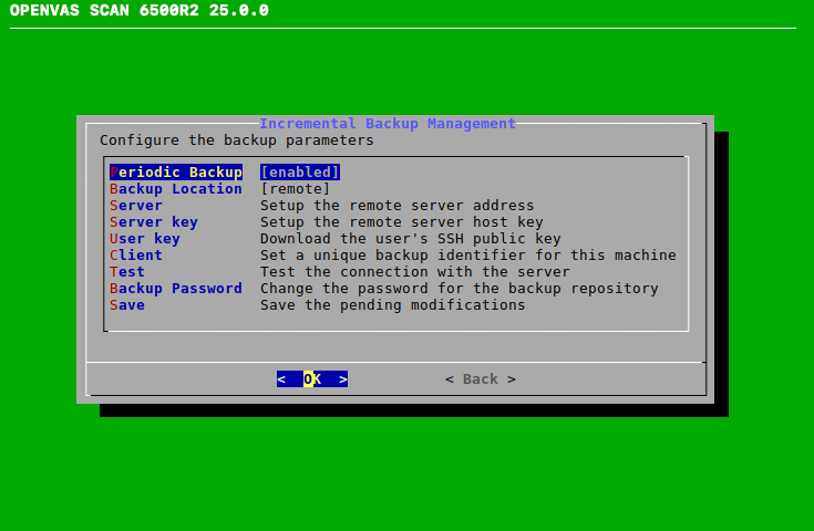

    _images/gos_menu_backup_1.png
    Fig. 6.50 Configuring periodic backups
6.2.12.2 Setting up a Remote Backup Server
By default, backups are stored locally. To store them on a remote server, the server must be set up appropriately. The appliance uses the SSH File Transfer Protocol (SFTP) to securely transfer the backups.
The remote server can be set up as follows:
  3. Select Backup Location and press Enter.
    → More options for the backup location are added (see Fig. 6.51).

  7. Select Server key and press Enter.
  8. Open the web browser and enter the displayed URL (see Fig. 6.52).
    _images/gos_menu_backupserverkey.png
    Fig. 6.52 Setting up the server key
  9. Click Browse…, select the SSH public key and click Upload.

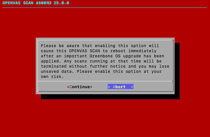

6.2.13.3 Configuring the Automatic Reboot
The appliance may reboot automatically after a successful GOS upgrade. However, a reboot is only performed when required, for example if the GOS Linux kernel is upgraded.
The automatic reboot is disabled by default. In this case, after a GOS upgrade that requires a reboot, a self-check warning is displayed asking to reboot manually.
This setting applies only to the appliance on which it is configured. It does not apply to all sensors connected to the appliance. If sensors should reboot automatically, each sensor must be configured separately.
  2. Select Upgrade and press Enter.
  3. Select Automatic Reboot and press Enter.
    → A warning informs that the appliance will reboot immediately after a GOS upgrade (see Fig. 6.54).
    All scans running at that time will be terminated. This can lead to the loss of unsaved data.
    _images/gos_menu_auto_reboot.png
    Fig. 6.54 Enabling automatic reboot

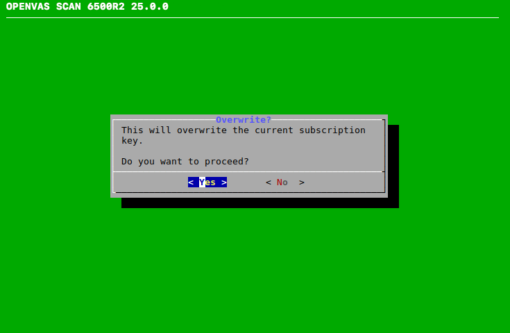

A new subscription key can be stored on the appliance by either uploading it via HTTP or by copying and pasting it using an editor.
For information about the subscription key see Chapter 6.1.1.
The new key will overwrite any key already stored on the appliance.
When the subscription key is overwritten, the state of the feed on the appliance is reset to “No feed present”. A feed update must be performed after adding the new subscription key.
Adding a Subscription Key via HTTP
The key can be added via HTTP as follows:
  2. Select Feed and press Enter.
  3. Select Key(HTTP) and press Enter.
    → A message informs that the current subscription key will be overwritten (see Fig. 6.55).
    _images/gos_menu_gsfkeynew.png
    Fig. 6.55 Overwriting the current subscription key
  4. Select Yes and press Enter.

Adding a Subscription Key Using the Editor
The key can be added using the editor as follows:
  3. Select Key(Editor) and press Enter.
    → The editor is opened.

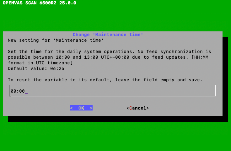

The time of the automatic feed synchronization can be set by changing the maintenance time (see Chapter 6.2.22).

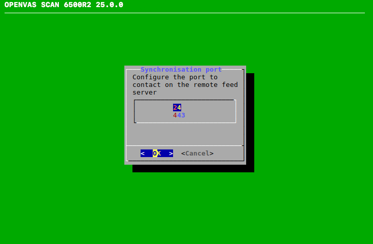

6.2.14.3 Configuring the Synchronization Port
The OPENVAS ENTERPRISE FEED is provided by Greenbone on two different ports:
  • 24/TCP
  • 443/TCP
While port 24/TCP is the default port, many firewall setups do not allow traffic to this port on the internet. Therefore, changing the port to 443/TCP is possible since this port is most often allowed.
Port 443/TCP is usually used by HTTPS traffic. While the appliance uses this port, the actual traffic is not HTTPS but SSH since the appliance uses rsync embedded in SSH to retrieve the feed. Firewalls using deep inspection and application awareness may still reject the traffic.
The port can be configured as follows:
  3. Select Greenbone Server and press Enter.
  4. Select Sync port and press Enter.
  5. Select the desired port and press Enter (see Fig. 6.56).
    _images/gos_menu_feedsyncport.png
    Fig. 6.56 Configuring the synchronization port

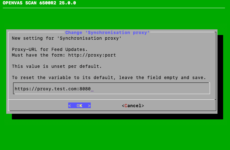

6.2.14.4 Setting the Synchronization Proxy
If a security policy does not allow for direct internet access, the appliance can use an HTTPS proxy service. This proxy must not inspect the SSL/TLS traffic but must support the CONNECT method. The traffic passing through the proxy is not HTTPS but SSH encapsulated in http-proxy.
The proxy can be set as follows:
  4. Select Sync proxy and press Enter.
  5. Enter the URL of the proxy in the input box (see Fig. 6.57).
    The URL must have the form http://proxy:port.
    _images/gos_menu_feedsyncproxy.png
    Fig. 6.57 Setting the synchronization proxy

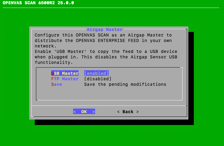

  1. In the GOS administration menu of the Airgap master, select Setup and press Enter.
  3. Select Airgap Master and press Enter.

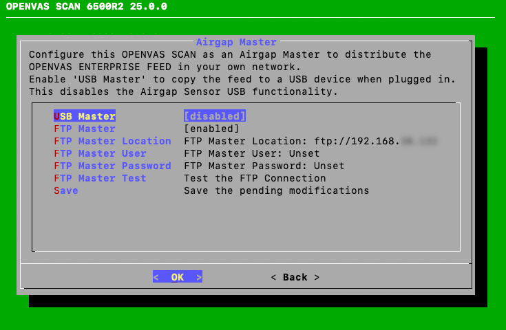

  4. Select USB Master and press Enter (see Fig. 6.59).
    _images/gos_menu_airgapmaster_usb.png
    Fig. 6.59 Configuring the Airgap USB master
  5. Select Save and press Enter.
    Configuring an appliance as an Airgap USB master disables the possibility to configure the appliance as an Airgap USB sensor at the same time.

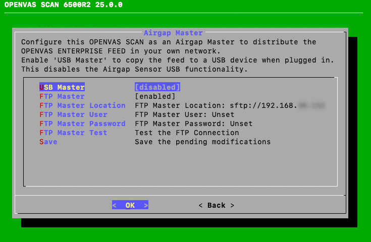

6.2.15.2.1 Transmission Using FTP

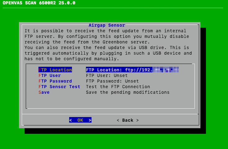

The configuration of an Airgap FTP setup is performed as follows:
  4. Select FTP Master and press Enter.
  5. Select FTP Master Location and press Enter.
  6. Enter the path of the FTP server in the input box and press Enter.
    • The required format for the path is ftp://1.2.3.4 or ftp://path.to.ftpserver.
    • Optionally, a port can be configured, for example ftp://1.2.3.4:21.
    • If no port is configured, the default FTP port 21 is used. If a port other than 21 should be used, it must be configured explicitly.
    → The menu options for the configuration of the FTP server are shown (see Fig. 6.60).
    _images/gos_menu_airgapmaster_ftp.png
    Fig. 6.60 Configuring the FTP server for the Airgap master
  7. Select FTP Master User and press Enter.
  8. Enter the user used for logging into the FTP server in the input box and press Enter.
  9. Select FTP Master Password and press Enter.
  10. Enter the password used for logging into the FTP server in the input box and press Enter.
  11. Select FTP Master Test and press Enter.
    → It is tested whether a login with the entered information works.
  12. Select Save and press Enter.
  13. In the GOS administration menu of the Airgap sensor, select Setup and press Enter.
  14. Select Feed and press Enter.
  15. Select Airgap Sensor and press Enter.
  16. Execute steps 5 to 12 in the GOS administration menu of the Airgap sensor with the same entries as for the Airgap master.
    The menu options have slightly different names than in the GOS administration menu of the Airgap master (see Fig. 6.61).
    → The data transfer starts during the next feed update.
    _images/gos_menu_airgapsensor_ftp.png
    Fig. 6.61 Configuring the FTP server for the Airgap sensor

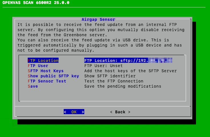

  16. In the GOS administration menu of the Airgap sensor, select Setup and press Enter.
  17. Select Feed and press Enter.
  18. Select Airgap Sensor and press Enter.
  19. Execute steps 5 to 15 in the GOS administration menu of the Airgap sensor with the same entries as for the Airgap master.
    The menu options have slightly different names than in the GOS administration menu of the Airgap master (see Fig. 6.63).
    _images/gos_menu_airgapsensor_sftp.png
    Fig. 6.63 Configuring the SFTP server for the Airgap sensor

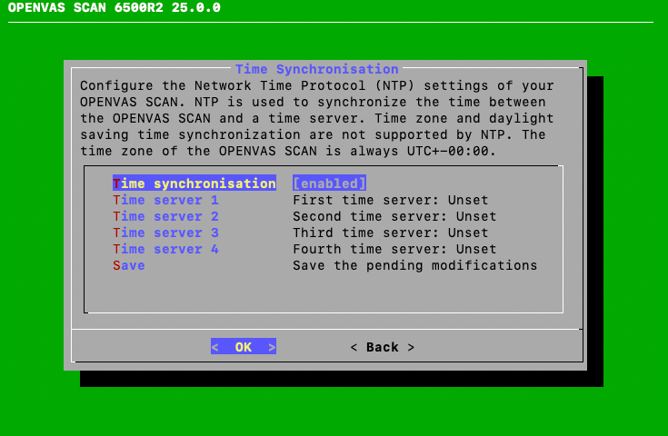

6.2.18 Configuring the Time Synchronization
To synchronize the appliance with central time servers, the appliance supports the Network Time Protocol (NTP). Up to four different NTP servers can be configured. The appliance will select the most suitable server. If a server fails, another server is used automatically.
Both IP addresses and DNS names are supported.
Time zone and daylight saving time synchronization are not supported by NTP. The appliance’s time zone is always UTC±00:00.
The NTP settings can be configured as follows:
  2. Select Timesync and press Enter.
  3. Select Time synchronisation and press Enter.
    → The time synchronization is enabled.
