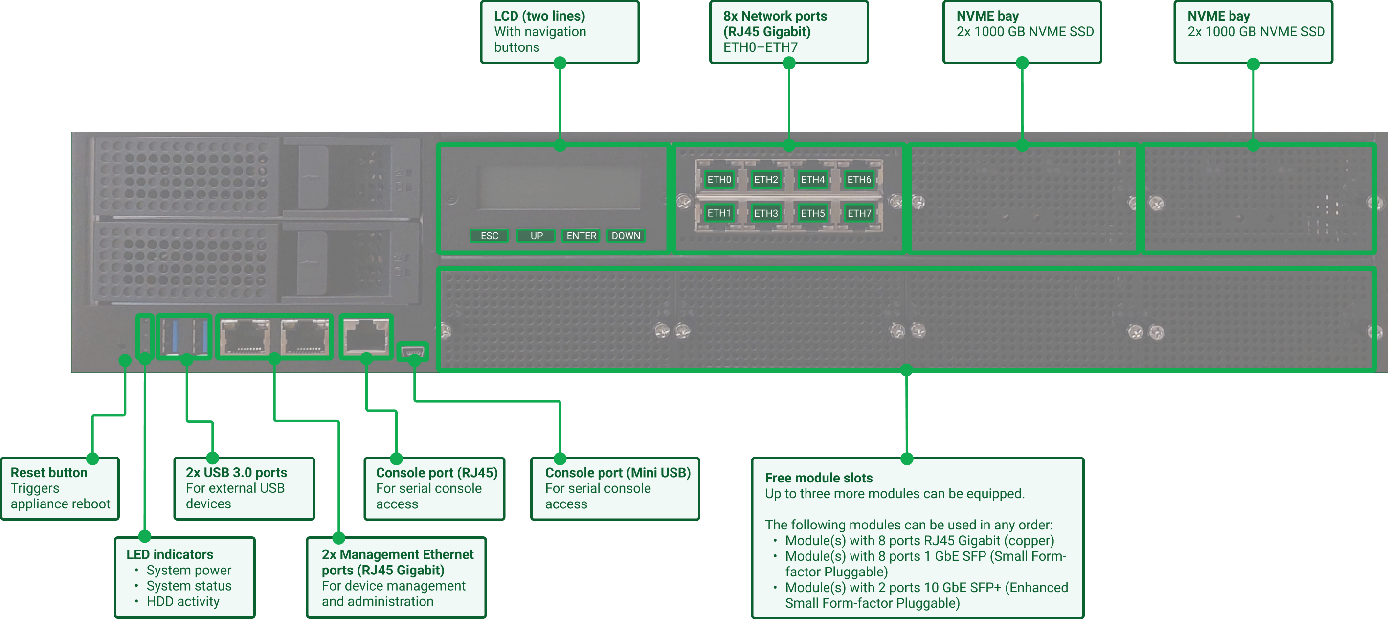

_images/hardware-large-front.png
Fig. 3.1 Hardware front with labels

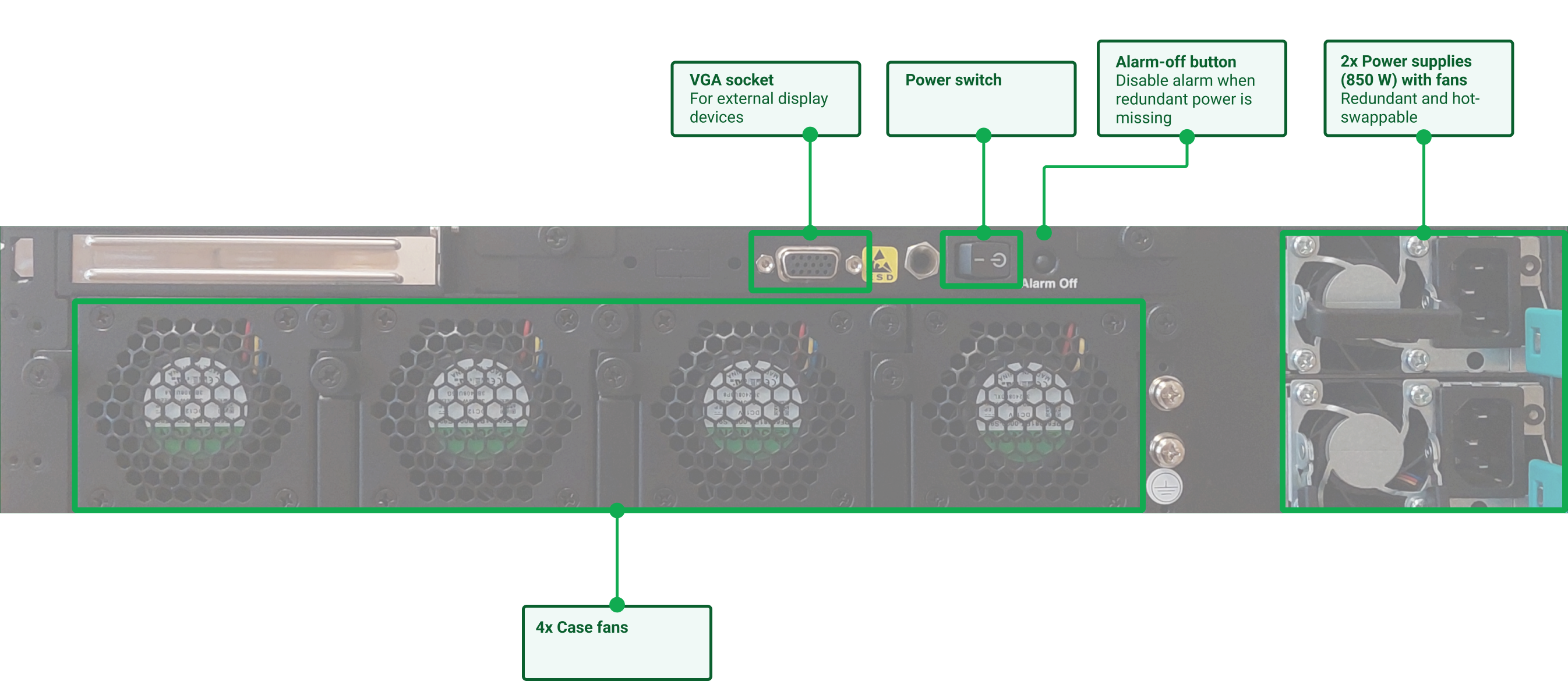

_images/hardware-large-back.png
Fig. 3.2 Hardware back with labels

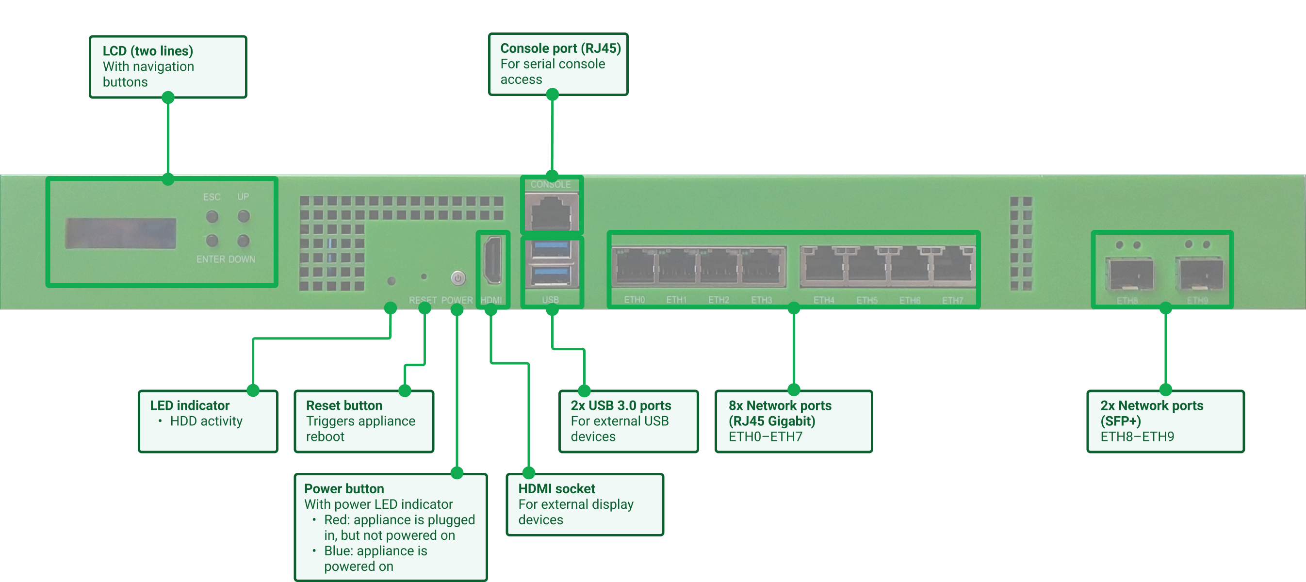

_images/hardware-medium-front.png
Fig. 3.3 Hardware front with labels

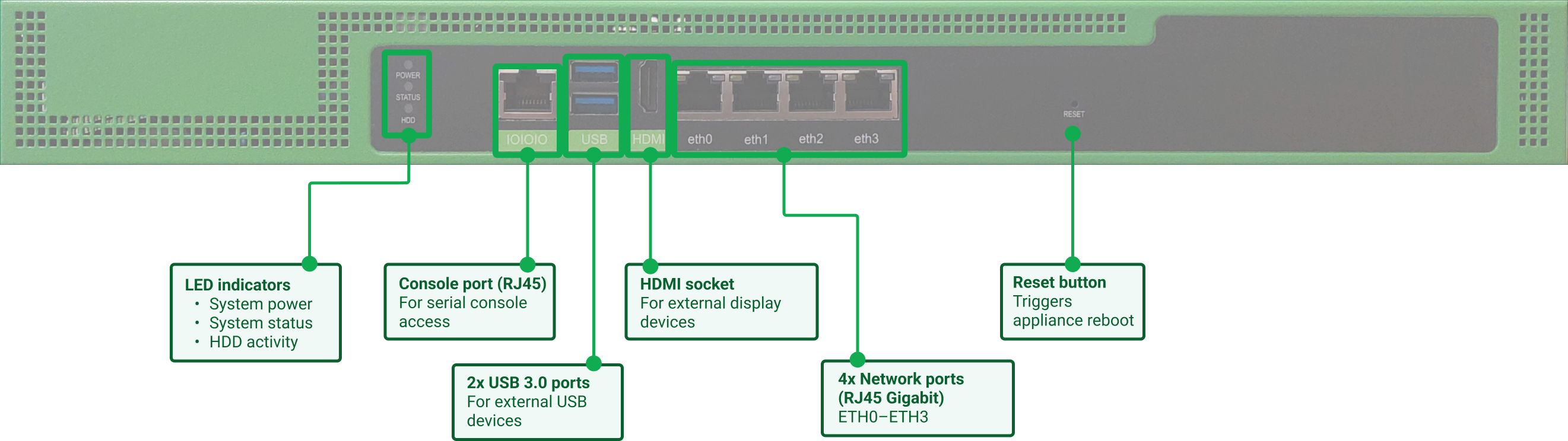

Fig. 3.5 Hardware front with labels

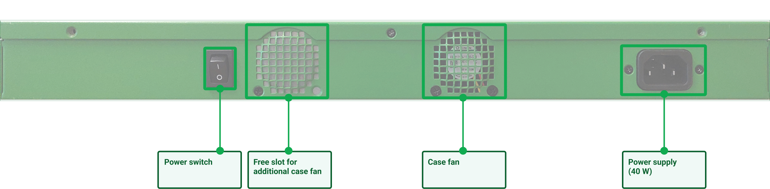

_images/hardware-small-front.png
Fig. 3.7 Hardware front with labels

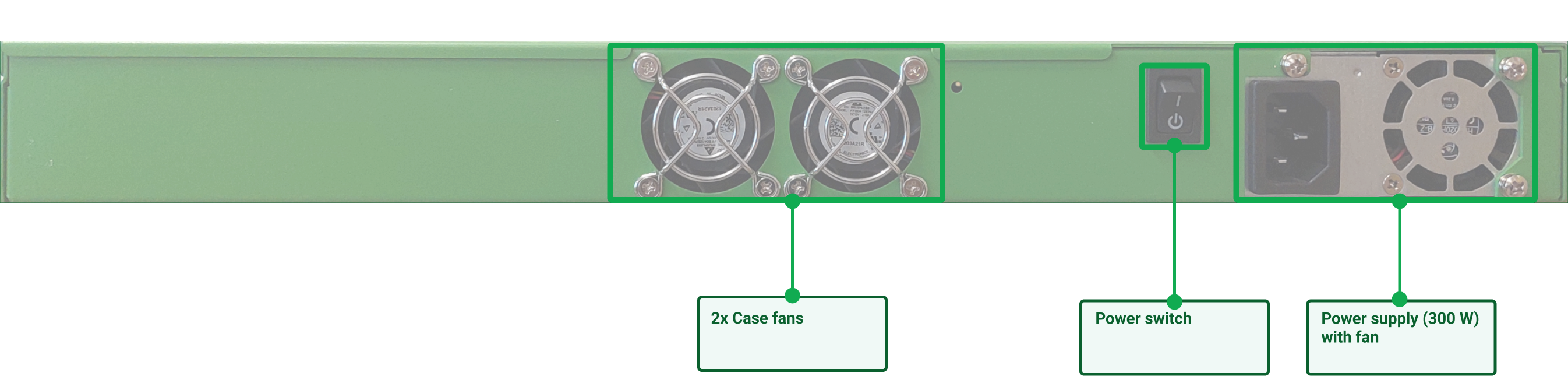

_images/hardware-small-back.png
Fig. 3.8 Hardware back with labels
